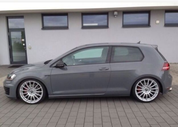

And Oz SUperturismo:
[Blockierte Grafik: http://i1375.photobucket.com/albums/ag456/vwmk7wheels/ozsuper3_zpsecdfbb23.jpg]Regards,
